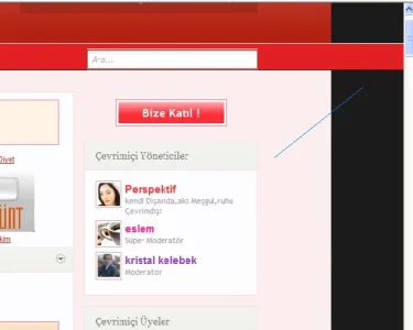

How do we change the Alert/Inbox counter from Blue to Read... I dont like it being blue, it doesn't stand out.
Template: navigation.css
Edit background under:
.navTabs .navLink .itemCount (box)
.navTabs .navLink .itemCount .arrow (arrow)
According to the Flexile Style Properties, the Alert Baloon is already set to RED... why is it blue on my skin?
I think the .css template overrides the Style Properties, but doesn't change it (mine [not Flexile] are gray, but Style Properties shows red, I think).
Well there are a lot of changes in Beta5... hopefully Erik can release the alert box fix with the next version.
It should be blue by default.
If you're referring to the @importantColor Style Property, that is used for the Moderation Queue/Reported Items alert counts, but not the regular alerts. The regular alert count boxes will be changed to have a background of @importantColor in the beta 5 release, which will be coming this weekend. :)

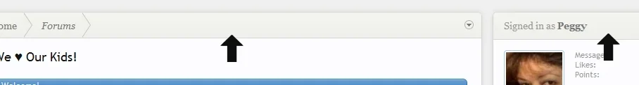

Erik, Could you please help me out. I've tried to find this item but to no avail and it's driving me nuts (short trip I know, but still.........)
I want to reduce the height of this (where the arrows are pointing), but can't find it!
Thanks in advance. :)
It's actually pretty complicated, but you need to change:
line-height of .breadcrumb .crust a.crumb
border-width of .breadcrumb .crust .arrow
border-width and top positioning of .breadcrumb .crust .arrow span
margin of .breadcrumb .jumpMenuTrigger
margin and padding of .sidebar .section .primaryContent h3, .sidebar .section .secondaryContent h3 if you want the sidebar headers to match.
Hope this points you in the right direction. :)

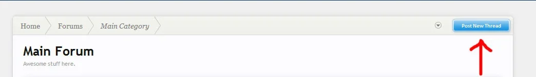

I'm in the middle of updating the style to beta 5, and I decided to add a feature to change the height of the breadcrumb bar using a single value, but I'm running into a problem:
What happens to the button when the breadcrumb get's narrower? How would you solve this problem?
Oh you know what ? I hadn't even considered that button. I was only thinking of forum home. Soooo, what I would do is to leave it the way it is. Seriously.
