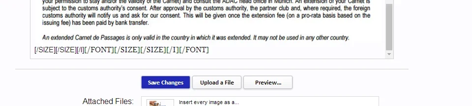

Yes its all members, i also have a couple of other strange things happening
- When editing posts - in wysiwyg mode when saving it appears to add bb code at the end of the post
- When creating a new post - in Chrome only - i need to refresh the page to see the post box to write a new post.
