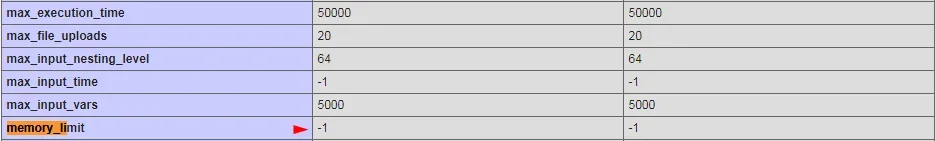

Hello,
By default I have this values in my phpinfo :
194840
My host said I need to add a file named php.ini in my root folder (server) to change "memory_limit = 512M" bu if I do that it also change others values. Is this correct or am I doing something wrong ? :unsure:
Regards, SyTry
This error is unrelated to the PHP memory_limit settings. Changing that won't do anything about this.
(Plus -1 means no memory limit so you'd actually be decreasing it. Saying that, the default is 128M and that's normally enough, but it should still be unrelated.)
