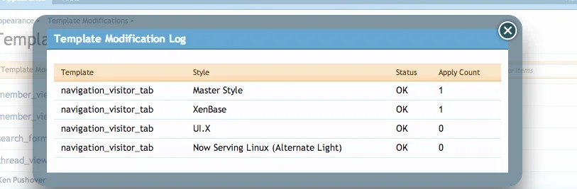

Quick question: How do i disable other associations if i only want Facebook, twitter and Google association?
@silence, there is apparently a template modification issue apparently with UI.X
The replacement text you are looking for is not in the default navigation_visitor_tab template but in the uix_visitorTabs template.
