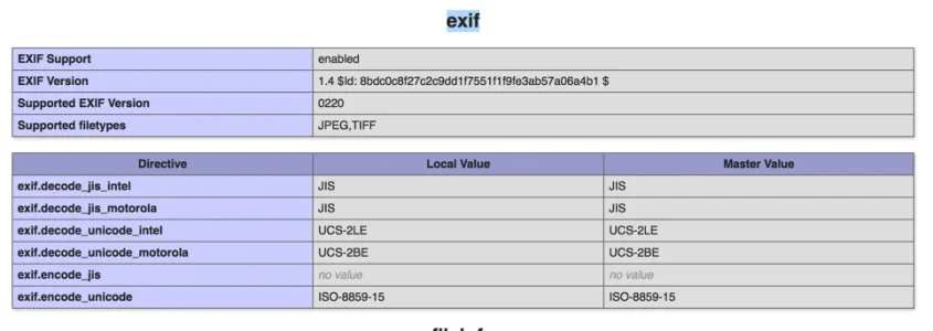

Hmm it doesn't appear that I have exif rotation installed, I don't see it on my list when I look at phpinfo...and I'm having a hard time finding it in WHM, any hints?
NVM I found it, had to go through EasyApache, recompiling PHP now
Yup that was it, working now

I've got EXIF installed, and they show correctly in threads, but not when uploaded to the gallery.
I'm using Easy Apache and multi php if that makes any difference, with V7 on this particular site.. All versions of php on the server have exif compiled with it.
Based on what you've said, if it's working under normal conditions (e.g. uploading to a thread), it would point to the issue being with the add-on itself.
I understand your reasoning there, but by the same token it can't be your server if it works for normal attachments.
I would pursue this with the add-on author and your hosts if it's a server issue.
