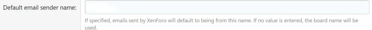

The difference is I'm sending emails from a forum user, in which case with this setting on doesn't appear from the sender (which is the bug). Sorry I didn't specify this earlier as I didn't think it was relevant. Please try to repro with forum email sent from user. (ACP > Setup > Options > Default Email Sender Name):

Happy path:
1. ACP > Setup > Options > Default Email Sender Name not set
2. User with email user@internet.com submits contact us form
3. Email sent to admins with from name field and from address field of user@internet.com
Bug:
Steps to repro:
1. ACP > Setup > Options > Default Email Sender Name set to Xenforo User "Admin"
Expected result:
- Email sent to admins with from name field and from address field of user@internet.com
Actual Result
- Email sent to admins with from name of "Admin" (user name in step 1) and from address of of user@internet.com

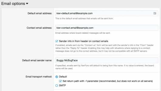

@rfc0001 could you attach a screengrab of your email options please? I've just tested it with the following settings, and it behaved as expected:
The result was an email sent to kier+contact.email@example.com from TestUser <testuser@example.com>, so it would be useful to see exactly what settings you're using so we can attempt to reproduce the issue using your exact configuration.
@rfc0001 can you confirm that you have enabled the Sender info in header on contact emails option?
I have the following results:
Sender info [ON]
Default email sender [Buggy McBugFace]
Result: Contact for email from: Username <username@example.com>
Sender info [ON]
Default email sender [empty]
Sender info [OFF]
Result: Contact for email from: Buggy McBugFace <kier+default.email@example.com>
Sender info [OFF]
Result: Contact for email from: {Board Title Option Value} <kier+default.email@example.com>
We've put in a workaround for this, it should now send with the correct from name when Sender info in header on contact emails is disabled, as I suspect it is in your case, @rfc0001
