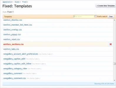

Whenever you edit a template, it should turn red to know that you modified the file and so you can revert it. but mine is not. Something you want to look at.. I was editing the xenforo_sections.css.
this is from the 1.2.1 release.
Etchel
Mine is not I edited the subheading part and it's not turning red. I wonder what did I do wrong.
you can see the difference in my website www.avcsgroup.net then here's the screenshot of my template section. I edited the #subHeading to be accurate. I feel like I have to do manual on mostly all of my suspected edited templates that was not possibly edited.. *cries*
Mike
XenForo developer
Staff member
You probably edited a style property within the template. Nothing to worry about.
