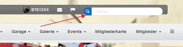

Hi Mike,
the searchfield must be a little bit higher in the userbar.
In the sticky navigation it is correct.

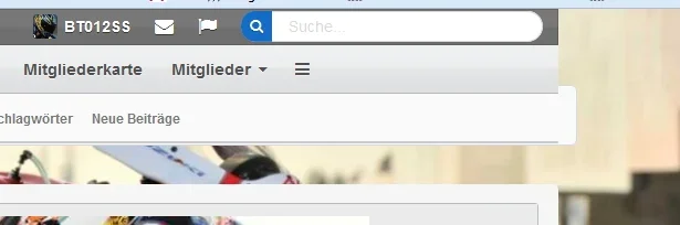

In the dark style i can see the arrows.
Maybe a problem between parent and child style?

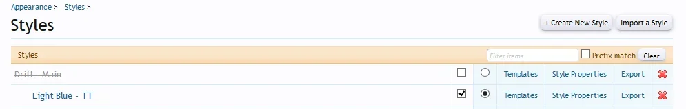

I don't have my one setup like that any longer and in the main style I also cannot see the arrows. This is how my structure is setup

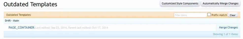

However since the upgrade I have the following issue and wonder if this is the cause of the arrows not showing, running auto merge does not fix it.
@Mike Creuzer do you have any ideas on this please?

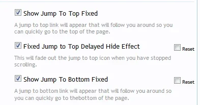

It depends which default configuration you have turned on for these to work. In fact, the force background settings only work for page style 0 and Drift by default has page style 2 on. I think this was toggled off accidentally in 1.4.1 but it has been fixed in 1.4.2
@Mike Creuzer will we be seeing a fix for this issue any time soon then?
We changed the name, so you just have to go back into UI.X Footer and turn the setting back on. If you've done that and its not working please create a ticket.
I see it now, that´s right. but why does the update change my child?

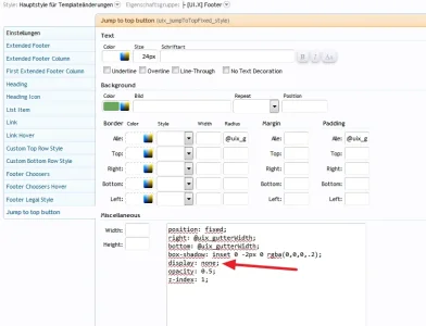

For @DaveM some more, when i delete this line in the "Jump to Top Button" css of UI.X i can see the arrow again.
But, the arrow will not fade out and stop at the top of the page, it stop under the breadcrump.

Revert the style property. Do not remove the display none it's needed for the fade.
Hi,
i can revert the propertys all 5 minutes, there is no arrow in the parent and child style.
when i remove the display: none; than i can see the icon.
