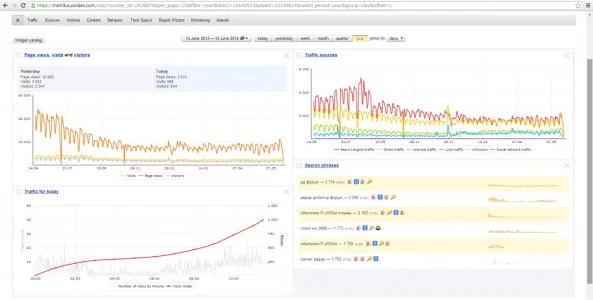

@craigiri Do you admit that software change could cause a double drop in search only because Google do not tolerate it? I have to say in may case that more than 55% of traffic goes from Yandex, not from Google and this fall could be more dramatic if Google had it's usual part.
To present my statistics better I attach Yandex.metrika (it's just looks more clearly than GA):metrika_yandex_xf.webp
If you can see drop of traffic after 31.07 it is just the time of import. After this there was a temporary grow and then stable fall.
