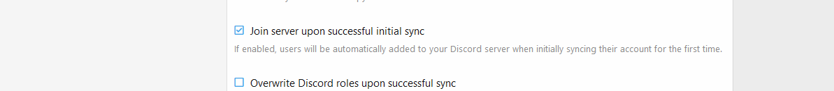

yeah I've found that and the user is joining the server as a welcome message appears for the other users in the main channel.
But the user who just registered.. how can he/she access the discord server?
just opening discord won't cut it

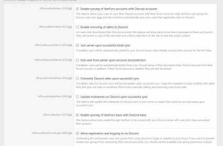

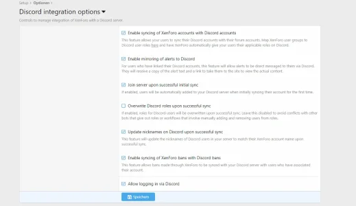

Could you screenshot your options page for the Discord Add-on?

Here are the options, I do not think you can separate registration and logging in with Discord.
The way it's worded, does it mean registering and THEN logging in from Discord? Or is that two separate things, like they can register OR they can also login via Discord? In other words, are they able to post in my forums with their Discord account and not have to register to my forums?
I'm not quite sure I understand what you mean. Enabling the option means guests can register and login with Discord. It also means that any users who have manually connected their accounts can use Discord to login. You don't need to have registered with Discord, you can connect the account later. There's currently no way to disable one or the other.
