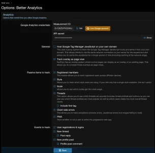

What if that value has never been filled? How can I re-generate the value? Where is the button to redo that?
This is what I see in the Admin CP... but I don't see anything about re-generating a secret key.
Admin -> Tools -> Rebuild caches -> Reset analytics encryption key
