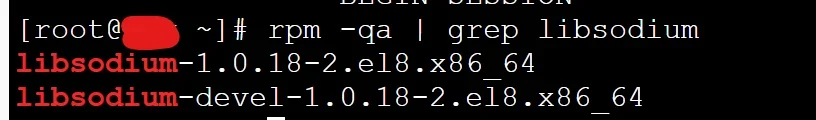

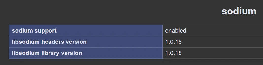

That is a constant in Sodium. So if that constant isn’t there, Sodium isn’t installed. What version of Sodium does it say is installed for you?

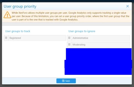

Can't save tracking 2 user groups, whether guests/unregistered or otherwise if registered is saved.
First one saved
Attempting to save second one.
Still
If I remove the groups and save...
Then try to save both at once again (instead of save one, then open it to save a 2nd).
It doesn't save and still get this.
And, then it won't let me change it to registered and save it again with just the one group. I get this again.
Xenforo 2.3.2
Yes, same on 2.3.3
I went back and saw that we were tracking 4 usergroups. Moving them out to track only registered usergroup. Saved it but it shows nothing tracked.
Looks like it's a XenForo bug with their Nestable function. See:

Not sure what's going on with your install of PHP, but SODIUM_CRYPTO_SECRETBOX_NONCEBYTES is a predefined constant of Sodium no matter what the version of PHP that's installed. So if that's missing, something is definitely mucked somehow with that extension in your PHP setup.
I also just double checked the PHP source, and it's in there (registered if the Sodium extension is compiled in):
It's also part of the simple test PHP does on itself to make sure it compiled properly:
Honestly, I'm not really sure how or why it would be, but the only thing I can think of is somehow you have a non-standard Sodium extension that had the source code altered before it was compiled. Again, not sure why someone would ever do that, but nothing else I can think of that would result in the Sodium extension being installed without the SODIUM_CRYPTO_SECRETBOX_NONCEBYTES constant.
I have the same problem as @frm, is the bug really fixed by Xenforo as the prefix of the post you mentioned?
