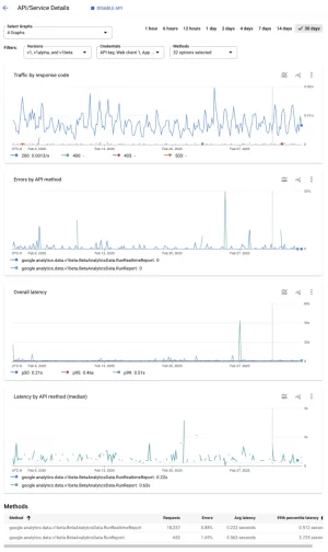

It doesn't process, modify or utilize the data in any way beyond the obvious... The API can help a user setup a web property, it can fetch reporting data on demand for reports in the admin area (under Admin -> Logs -> Analytics). API calls are never made beyond those cases, and the data from the reporting API calls is never saved or transmitted. The API calls for creating a web property does result in the Measurement ID being saved and also transmitted to Google (it's how Google knows what property to assign events to).

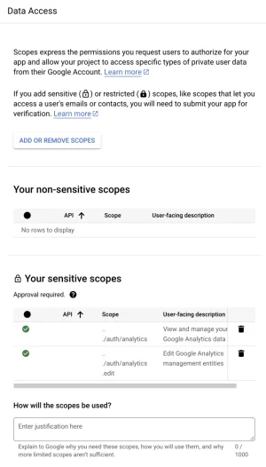

Sure, but not really sure how that would happen, as it's not an "application", it's a project under Google's API Console. Google itself had to audit requested scope usage in order to use their APIs for the project. Giving a third party access to the project in the Google API Console really doesn't do much other than them being able to see, "yep, it's a Google API project..." but we already know that.

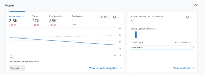

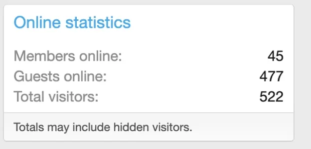

About the same here, but I forgot my original username and password. While DigitalPoint has dealt with legal matters in the past, they aren’t relevant to this discussion, so I won’t revisit old issues. That said, those events have nothing to do with my skepticism about Better Analytics. My concerns stem purely from observing a spike in bot activity when it was installed and a drop when it was removed, which made me curious about what was happening behind the scenes, whether it was an issue with the add on or with the Project.I've been a member of DP for 20 years, I have utmost belief in his credibility.

A spike in bot activity definitely isn't coming from this addon... at least not directly. Maybe if a bot or process was monitoring your site just to see if it was using Google Analytics (the event tracking requests aren't hidden to a browser), they could do something. But seems like a lot of work and not particularly practical to spend time monitoring and waiting for a site to use Google Analytics before it sends bots.About the same here, but I forgot my original username and password. While DigitalPoint has dealt with legal matters in the past, they aren’t relevant to this discussion, so I won’t revisit old issues. That said, those events have nothing to do with my skepticism about Better Analytics. My concerns stem purely from observing a spike in bot activity when it was installed and a drop when it was removed, which made me curious about what was happening behind the scenes, whether it was an issue with the add on or with the Project.
