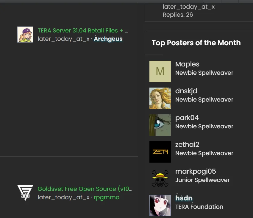

Happening on mine too, but only once in awhile. It looks like this...
Site is https://www.satelliteguys.us
