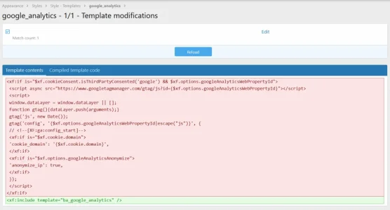

I just spent a bit of time trying to figure out why there were still calls going out to googletagmanager.com with the Host Google Tag Manager JavaScript on your own domain option enabled.
I found two of @Siropu's addons we use (Ads Manager and Custom 404) have templates with <xf:include template="google_analytics" />, which aren't affected by this addon's template modification replacing <xf:include template="google_analytics" /> in PAGE_CONTAINER.
I disabled the default template modification and created a new one, replacing the contents of google_analytics with <xf:include template="ba_google_analytics" />, and now I'm getting a single request.
You know way more than I do about this stuff, maybe you have a better way to make this more resilient. I just wanted to post to let you know about a potential issue, and to let others know to inspect their sources to make sure they're not duplicating requests :)
I probably wouldn't replace google_analytics template like that... then you have the potential of having ba_google_analytics added twice.
Not sure what would cause what you are seeing, but custom styles and/or other addons doing something funky are most likely the culprit. If you want to go down the road of figuring out what it is, you may want to set it back to the way it was when it's doing the double requests, and slowly disable other add-ons one by one until it stops doing it. Then at least you know which add-on to look deeper into.
Good point! I'll figure out something else :)

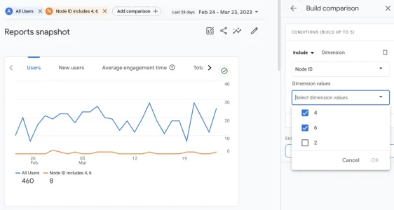

As long as you have the option to track Node in your addon settings, then yes, that can be applied to any GA4 report. If you pull up a report in GA4, the Add comparison operator is the simplest way to do it. For example the orange line is just Node ID 4.
Thanks, that's awesome. My ad ops team have a further question. Is it possible to see the aggregated data for whole categories rather than adding up all the subforums?
You can use the same comparison system to do more advanced selections... for example you could in fact select multiple nodes to be aggregated to a single value. You won't be able to just pick a forum from a drop-down and have it automatically generate it, so you still would need to pick the node IDs you care about. For example, node ID 4 and 6:
