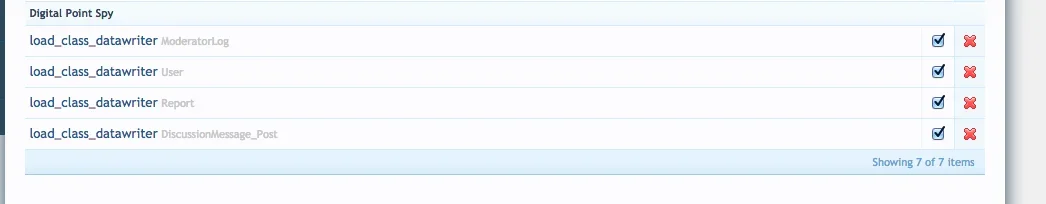

So I did that and went into the Code Event Listeners, but the template_hook wasn't under the Digital Point area.
So could un check it.
