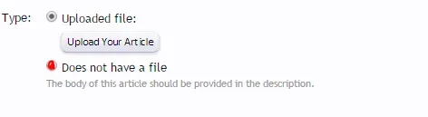

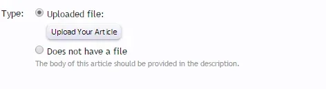

When submitting a resource,
How to change so the form has these checked by default. Which template should I edit?
Extra.css would be great!
Thanks

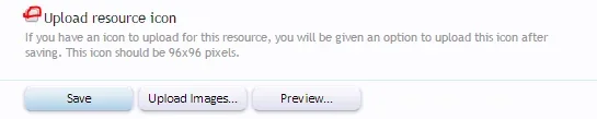

For the icon:
Rich (BB code):
<label><input type="checkbox" name="edit_icon" value="1" checked="checked" /> {xen:phrase upload_resource_icon}</label>
Thank you for the reply. I am not able to figure out what need to be changed in the template to default check - upload resource icon and "Does not have a file" options.
Thank a lot @Brogan
1) I still want to upload files but only <5% resources have files and the reason I would like to have "Does not have a file" auto checked.

For the icon:
Rich (BB code):
Change this:
Rich (BB code):
<li><label><input type="radio" name="resource_file_type" value="fileless" {xen:checked '{$resourceType} == "fileless"'} /> {xen:phrase does_not_have_file}</label>
To this:
Rich (BB code):
<li><label><input type="radio" name="resource_file_type" value="fileless" checked="checked" /> {xen:phrase does_not_have_file}</label>
