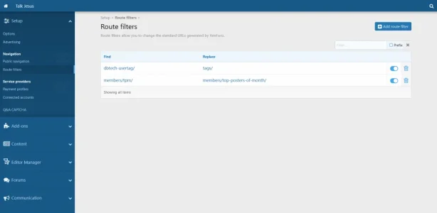

Are you sure the route filter hasn't changed? Have you triedDon't know what's happening here. Suddenly https://www.talkjesus.com/tags no longer works. despite route filter in place.

Does the default URL work?I'm sure the filters have not changed. Showed you screenshot already.
https://www.talkjesus.com/tags/ doesn't work either.
Just because you misread my post doesn’t mean you have to be rude. The copy/paste error was on my end (code copied from the Credits addon), and it is fixed in the next upcoming version.I already did. Did you read my post?
You’ll find you have a better experience talking to customer support if you don’t talk down to them.
You might believe that, but it's also the right of service workers to not be talked down to.No reason to be rude to your customers. Custom is always right.
Having looked into this, this is actually working as intended. There is no index page for this mod, pages are only accessible by, for instance, clicking on a hash tag in a post. That will generate an URL like
/dbtech-usertag/hashes/test.1/
which does work.I can't imagine it would notify 14k members as that would likely cause the process to halt and be aborted.When a user tags @ Administrative it notifies all users that they have been mentioned instead of just the Administrative group members.
