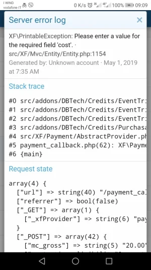

Another important error to report. This occurs when a user purchases currency using PayPal. Before the upgrade everything worked fine as it's not the first payment we get. I checked the event trigger and saved it (just in case) but the problem is not solved unfortunately. The user also reached me out to report he didn't receive any currency and he's quite upset about it (of course).

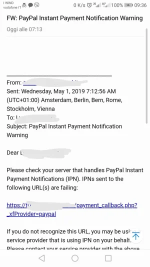

And it looks like this is getting serious as even PayPal notified me about it:
201399
Account upgrades work fine, so I'd exclude a payment misconfiguration in the admin panel.
I can't assist with this as you have posted a screenshot of an error message instead of the error message itself. As you can tell by the screenshot, the information is heavily cut off and the important information is missing.
My bad, there you go:
 #0 src/addons/DBTech/Credits/EventTrigger/Purchase.php(46): XF\Mvc\Entity\Entity->save()

Great, thank you. I have applied a hot fix to RC1 that should resolve this issue. If you re-download the zip file and use the add-on installer to rebuild it, it should be fixed going forward.

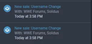

I'm receiving duplicated PM alerts for purchases since latest version.
