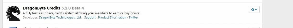

i istalled 5.1.0 Beta 4.

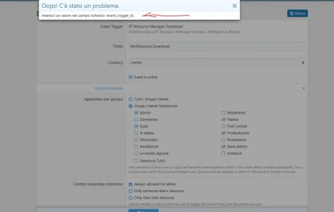

Hi Fillip. I have another problem. I show it in a picture. When I save the setting an error message appears.

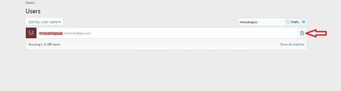

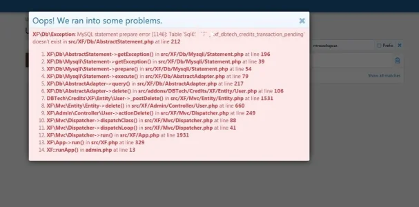

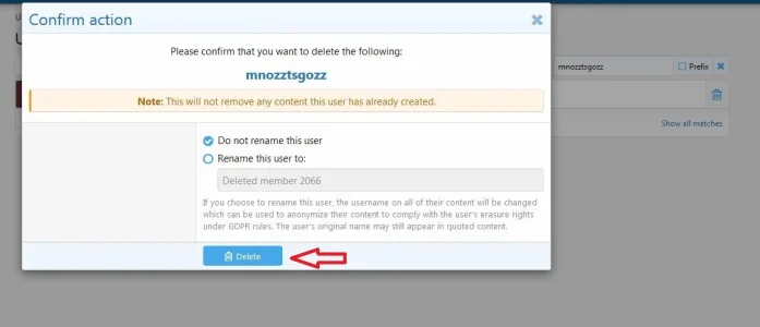

There is another bug. Version 5.1.0 Beta 6 . it is impossible to delete users. I attach photos
  • XF\Db\Exception: MySQL statement prepare error [1146]: Table 'Sql*****_4.xf_dbtech_credits_transaction_pending' doesn't exist
  • src/XF/Db/AbstractStatement.php:212

DELETE FROM `xf_dbtech_credits_transaction_pending` WHERE user_id = ?
#0 src/XF/Db/Mysqli/Statement.php(196): XF\Db\AbstractStatement->getException('MySQL statement...', 1146, '42S02')
#1 src/XF/Db/Mysqli/Statement.php(39): XF\Db\Mysqli\Statement->getException('MySQL statement...', 1146, '42S02')
#2 src/XF/Db/Mysqli/Statement.php(54): XF\Db\Mysqli\Statement->prepare()
#3 src/XF/Db/AbstractAdapter.php(79): XF\Db\Mysqli\Statement->execute()
#4 src/XF/Db/AbstractAdapter.php(217): XF\Db\AbstractAdapter->query('DELETE FROM `x...', 1684)
#5 src/addons/DBTech/Credits/XF/Entity/User.php(106): XF\Db\AbstractAdapter->delete('xf_dbtech_credi...', 'user_id = ?', 1684)
#6 src/XF/Mvc/Entity/Entity.php(1531): DBTech\Credits\XF\Entity\User->_postDelete()
#7 src/XF/Admin/Controller/User.php(660): XF\Mvc\Entity\Entity->delete()
#8 src/XF/Mvc/Dispatcher.php(249): XF\Admin\Controller\User->actionDelete(Object(XF\Mvc\ParameterBag))
#9 src/XF/Mvc/Dispatcher.php(88): XF\Mvc\Dispatcher->dispatchClass('XF:User', 'Delete', 'json', Object(XF\Mvc\ParameterBag), 'users', Object(DBTech\Credits\XF\Admin\Controller\User), NULL)
#10 src/XF/Mvc/Dispatcher.php(41): XF\Mvc\Dispatcher->dispatchLoop(Object(XF\Mvc\RouteMatch))
#11 src/XF/App.php(1931): XF\Mvc\Dispatcher->run()
#12 src/XF.php(329): XF\App->run()
#13 admin.php(13): XF::runApp('XF\\Admin\\App')
#14 {main}
