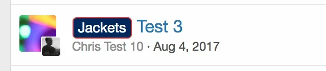

OK, there's a few things here.
First, as you have noted above, the class names have changed, so custom class names in XF1 would have been written as prefix jackets etc. In XF2 you will have to update all of your prefixes so the custom CSS class names are, e.g. label label--jackets (we made prefixes into a generic system named labels and we use them for other things besides prefixes, we also take a BEM approach to CSS styling hence the additional label-- bit).
If you tried to add your custom styling somewhere, it would have to look like this:
Less:
.label
    &.label--jackets { .m-labelVariation(white, #00285C, #E03A3E); }
Unfortunately in beta 1, if you attempted to add that to extra.less you will get an error as it can't see the m-labelVariation mixin.
So right now, you would need to add the code directly to core_labels.less. However, as of beta 2, we've moved some code around and you will be able to just put your custom code in extra.less (which is probably preferable).
The next problem is how the styling in the Admin CP works. When you add your custom LESS to a template, you will be adding it to a template in a specific style. When the style for the Admin CP is rendered, that style is actually coming from at least one level above your chosen style; it comes directly from the un-editable Master style. So, any changes you make to any style won't be reflected in the Admin CP. This means if you're looking at the list of prefixes and wondering why the colours aren't changing, it's because the style you're viewing doesn't have those changes. As a result, as of beta 2, we're basically going to be removing that prefix preview from the prefix list. Ultimately, you'll just need to apply the prefix to a thread and view it in the thread list.
With all those things in mind (updating the prefix class names, writing the code in core_labels.less, previewing the prefixes in the actual thread list) the end result should look something like:

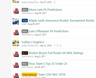

Sorry to bring this up once again, but with Beta 2 released, I upgraded my test site and tried inserting the following code into extra.less:

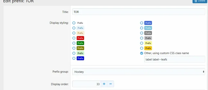

What do you have set as the custom class for the prefixes?
Here's an example of the Toronto Maple Leafs (I just used the same format as the standard ones, such as label label--orange, assuming that would work):
That looks correct so I'm not sure what would be causing them to display wrong on the front end. I'd suggest checking the obvious things first, e.g. making sure you've edited extra.less in the correct file etc.
Yep, I went through and verified I was editing the default style's extra.less template, so I'm a bit stumped as to why they're not displaying.
