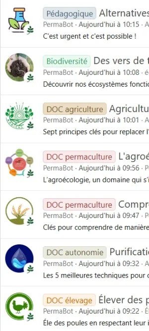

Following this resource (not for XF 2.3 but...), why custom prefixes are not styled by variation?
The syntax of the code is however the same as the original ones
Less:
&.label--yellow { .m-labelVariation(black, #ffff91, #e6e687); }
&.label--orange { .m-labelVariation(black, #ffcb00); }
&.label--error { .m-labelVariation(#c84448, #fde9e9, #c84448); }
//* CUSTOM PREFIXES
&.label--campBase { .m-labelVariation(#0099cc, #e6f9ff); }
&.label--permaculture { .m-labelVariation(#ac3939, #f9ecec); }

Initially, it appears that some labels are styled for the alternative style, while most are not.
The question then becomes: what is the syntax in a LESS template to target specific style variations?
For instance, how does one create a label for the light style and then create a corresponding label for the dark style?
Thank you.

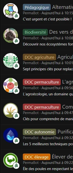

Oh i understand, so using m-labelVariation with HEX or hsl code is of no use, since we do not provide it with a color variable which contains the 2 colors (default/alternative), am I right ?
Less:
//* CUSTOM PREFIXES
Yes exactly, in that case you would want to use the mixin:
Less:
// CUSTOM PREFIXES
&.label--campBase
    .m-colorScheme({{ $xf.style.getAlternateStyleType() }},
         .m-labelVariation(#0099cc, #e6f9ff); // change these
         .m-labelVariation(#ac3939, #f9ecec); // change these
