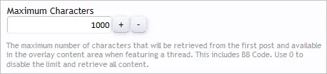

Do you mean this?Wasn't there an option a while back to limit characters in the preview? I know you had changed a good bit when it went to a more fluid setup and featured thread page.
Ah yes, that's an annoying aspect.
I originally wanted to use ellipsis on the content text but as you say, it doesn't work on multiple lines.
Do you mean this?
Do you want them to remain elastic and vary in height based on the content?
If so, you can simply edit the content when featuring and remove as much as you like.
Or if you want them fixed height like the blocks on the page, you can set the page style properties to match how the blocks are set.
