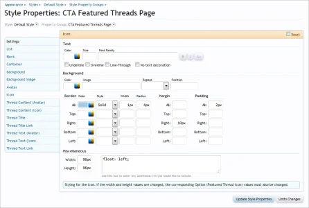

Okay, I see that's rather tricky. How about icon the same size as the avatar? (96x96) Setting this value in options doesn't work.
Adjusted the style properties too, got this,
Changing the options and style properties should make the icon the same size as avatars.
Are you changing the correct SP in the correct style?
Yea, it's set to 96x96 there too.

just to be sure, uploading a 200x200 icon will be resized instead of creating that large empty container right?
It works for me in my testing.
You can actually leave the option values at the default, it is the SP which controls it.

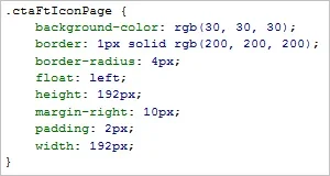

Looking at the CSS on your site, it is still set to 192px:
Check there are no outdated templates.

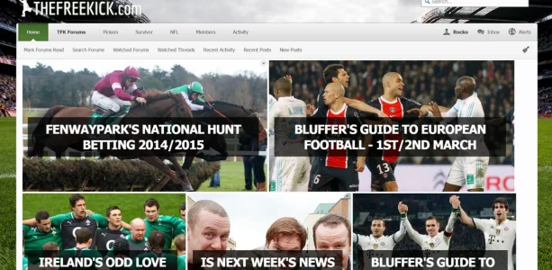

I got this add-on a few months ago, right after it was released. I put it live for a while then forgot about it and disabled it for a while. But had a look at it again last week and realised how useful it could be as a portal type front page.
I'm far from an expert on CSS or anything but with style properties and a few lines in extra.css (which I could probably have avoided if I knew what I was doing) I managed to come up with a front page that really suits me as highlighting a few threads in a grid. I have 5 there at the moment but intend on that being 8 or 11 soon and expanding the grid a bit.
In short, just want to say this is far more versatile and useful than I had originally thought. For me anyway it completely removes any advantage from something like Wordpress. So useful to be able to come up with striking front pages from within XF.
