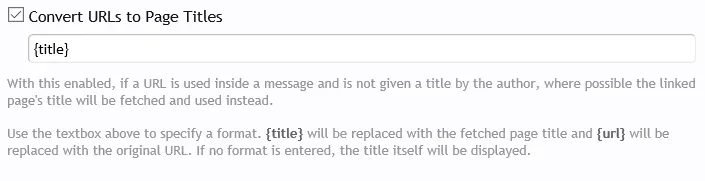

On my forum, the external links will be converted properly, but not the internal. How can it get ?
Just to confirm, you are talking about new internal links not converting? Existing internal links in posts that have previously been made won't auto convert.
