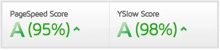

I've installed the addon and I've selected the option to compress the html
but I can't see any improvements in my GTmetrix report:
With or without addon I have the same numbers.

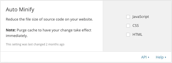

rafass
Hello BobbyWibowo, I'm using CloudFlare but I have the HTML compression dissabled:

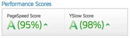

with or without this addon my score is always same. 95 - 98
I'll send you my report via pm cause my board is still under construction. ;)

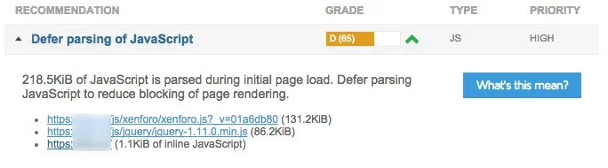

@BobbyWibowo I'd be interested to learn how you are deferring your javascript as that seems to be the biggest reason for me getting a B instead of an A
BobbyWibowo
@Rob I borrowed the deferrer function from this add-on: https://xenforo.com/community/resources/defer-js.2972/ and added it into my own personal add-on. Although I didn't change anything on the function, so it did whatever it was designed to. I've also been using UI.X-based theme (Antiquark) and I hadn't blacklisted anything but IE conditionals. All of my GTMetrix reports (set it to autocheck daily) reported that there were no issues with JavaScript deferring, so I believe it worked just well. I've also checked the website's source code to make sure that the <script> tags were correctly moved before </body> tag, and they did.
I've seen your replies about having issues with that add-on. To be honest, I'm clueless as to why you had those issues. Mind linking me to your recent GTMetrix report when you had that add-on enabled?
