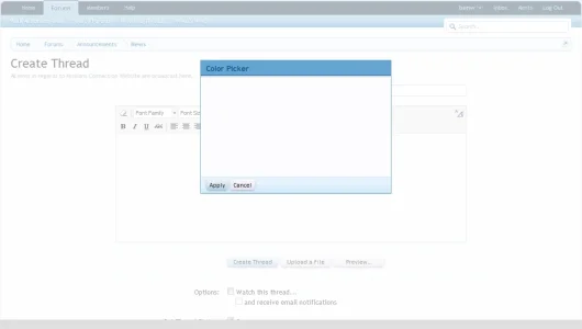

I am having an odd ball problem with Color Picker not loading. Its like it is there but does not show up. Is there something wrong with it, I haven't changed anything in regards to it at all.
I don't got any javascript errors in the Console for Chrome or firefox so I am not sure whats happening. On xenForo it works fine. Just the site I am working on.
Any ideas? If I gotta show you what I see I can take a screenshot.

Presumably that's after you click on "More Colors"?
Does it work with a different browser?
Do you have any add-ons installed or additional JavaScript?

I have no addons installed that do anything with javascript. The only addon that I have is what I've done so far. And this problem persisted before I added my add on work that I've been working with.
The problem occurs on FF, IE7+, Chrome and Safari, not sure about Opera but I am sure it doesn't there either

Create a new default style and check the functionality there.
If it works then it's a problem with your current style and you will need to revert the associated templates until you locate the problem.
Keep a copy of any changed templates though so you can reapply them.

That is the thing... the only file I modified was moderator_bar.css and logo_block which I only added one line and I reverted it, the css should have no affect as I only added a few changes to it and reverting that back had no affect either...

Here is the kick. When I view the offical iframe data in Chrome or firefox, the data is there, somehow it doesn't show up at all, I wonder if it is a style issue, I just don't know what I modified that may have caused it... Also I know its off topic, but I have a serious question, Right now... I have a Primary Style that is used for the forums, then I have a Child Style so that I can override the PAGE_CONTAINER so that my new front page looks different and doesn't include all that extra information I don't need. Now this is the big question I know as it has got to be possible. HOW do I change the PAGE_CONTAINER to be a different template rather than creating child themes??

I found the issue I think... The thing was I set the Body Width to be 1200px rather than fluid and when I removed that it showed up like it should... I think it was pushed to the far right or something so I couldn't see it or something...
The solution was just to override the editor_dialog.css perhpas this should be general override doing something like this:
#colorpicker
    width: 100%;
Because I am sure several sites may run into this problem when creating new styles...

Where did you specify the body width?
I have a fixed width on my site (992px) and don't have the same problem.

Ah, mine was making the entire site ie body tag width being set to a set fixed, that include the top header etc. not the page width controller
