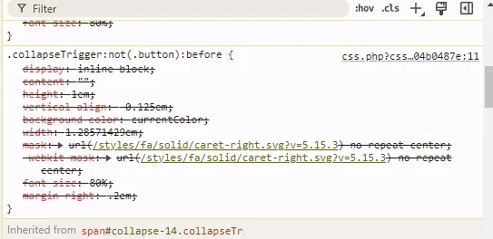

That is in extra.less - but you may misunderstand, what I meant. I switched the visual state of the button, not the initial state of the node....
Yes, I attempted to make a state change in CSS. That did not end well.
I am also looking around in the template_modifications.xml file, where the instructions seem to originate from. That has not ended well either... :cool:

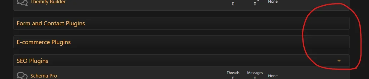

To help visualize why I would like to do this, here is the outcome I am seeking for those landing on the forum index page:
