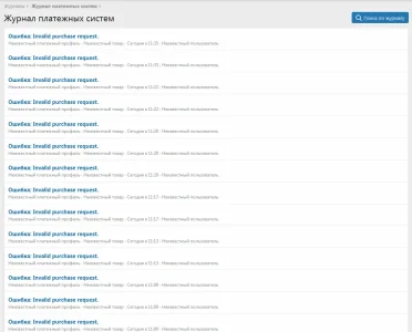

After updating to the last 1.0.2, I received a lot of errors. It's because of multiple domain. I initialize just 1 time coinbase payment from localhost (localhost copy of forum for my testing purposes). And now in web version are a lot of similar mistakes.
