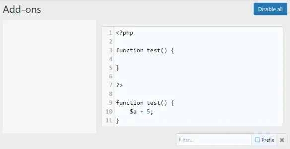

<xf:codeeditorrow mode="php" data-line-wrapping="true" class="codeEditor--autoSize" />
This code creates code editor row without any errors:

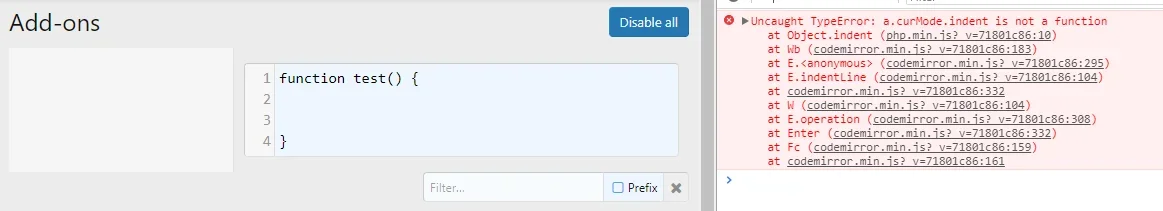

But the code is not highlighting and throws an error when hitting "Enter":
I think this error happens because of the incorrect mode calls order. "clike" mode should be loaded first and only after that "php" mode should be loaded. So I tried to change the order in CodeLanguage class:

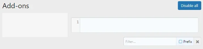

I did not notice any errors and the editor is even making automatic tabulation but still no highlighting...
Moreover, function has a cm-variable class but it must has cm-keyword class so there is something working completely wrong with mode="php"...
