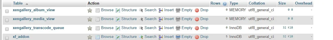

No joy, there were 3 but none were xengallery_field.
There were 3 what? There are three field related tables, but one of them is xengallery_field, and there are obviously considerable more than 3 tables in total. What were the 3 tables, specifically?

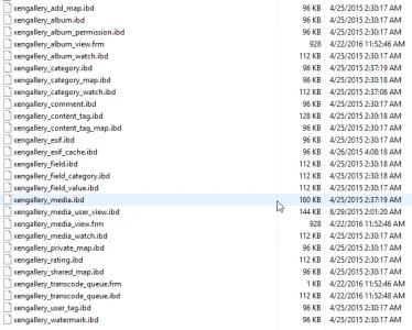

In the 'C:\xampp\mysql\data\dev' (dev being the xf install) directory there were these files. If you notice the date being from last year it is these that caused the issue since I had copied XAMPP from my old HD to this SSD and still used 'dev' as the install. ;)
See I knew it was something simple/obvious lol. Thanks for the help guys.
