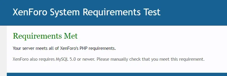

I have installed php 7.0 and i fullfill all other requirements ( xenforo requirements: https://puu.sh/xyXQw.png ) (php ver: https://puu.sh/xyY2h.png)

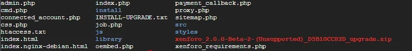

And other thing that i saw. Those guides talk about data and internal_data permisses, but i dont have those folders
var/www/html$
I saw the data folder on upload/src/XF but im not sure if this is the same folder...

I suspect you don't have either a data or internal_data directory because you downloaded the upgrade package which excludes those directories specifically.
Shouldn't be an issue though to just create those directories manually. If you do that, make sure they're world writable / chmod set to 0777 and ensure that is set recursively for all contents too.
