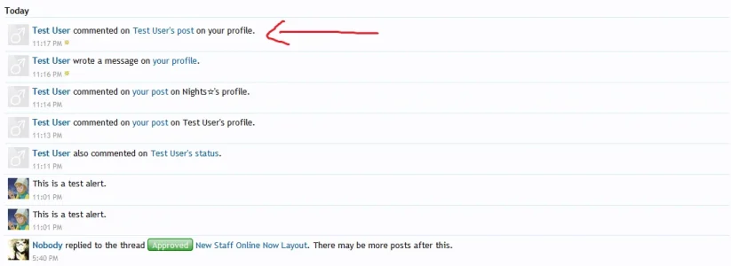

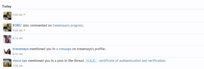

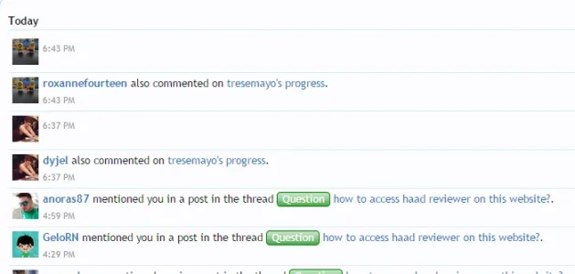

@Chris D, I don't really have any reproduction steps, but this has happened on our forum as well and I have some information that may help!
Making sure it wasn't a style issue, I tested it on the default style as well just to be sure, and it appears to be only with comments that were made before updating to 1.5. Everything still works properly and you get linked to the correct profile post, the phrasing is just broken.
Comment from when we were still on 1.4.9, before updating to 1.5.0:
Comment after updating to 1.5.0:
(Took me a while to figure how to comment and such in order to get that phrasing, haha!)
While the first and third screenshots are the Alerts page, perhaps it's something to do with the fact that comments didn't show up on the news feed before.
