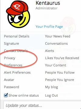

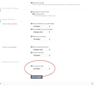

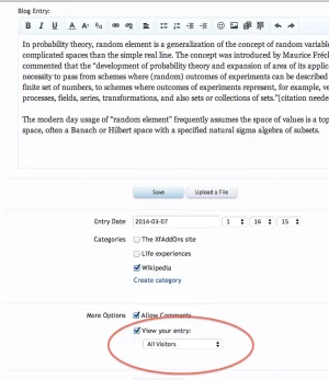

On the blog's account (whichever blog you want to be visible), what do you have the blog privacy options set to?
Screen Shot 2014-08-20 at 9.19.02 AM.webp Screen Shot 2014-08-20 at 9.19.18 AM.webp
Yup - same setting.
I'm testing using a blog I created:
My blog post can be viewed by a guest, and the post is listed under my /xfa-blogs/robart.1/
