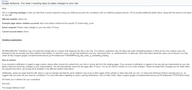

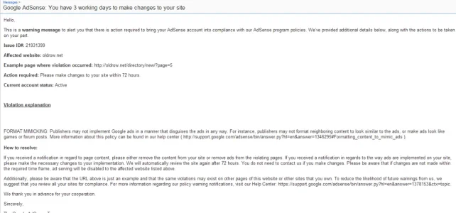

Here are the 2 messages they sent me... Format mimicking? I just pasted the code into the rotating ads add on, no formatting was done at all!
View attachment 53537 View attachment 53538
People often get those warning if they use the second post position. However, the mentioned link is for forum_view and directory (is that an add-on?) so it's not clear for now. Which positions are you using?
