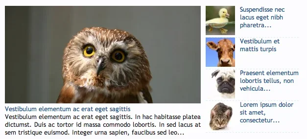

Can someone tell me what the settings should be to get this?
I have fooled around in the settings too much, so its a mess now, and I dont remember how the settings should be.
