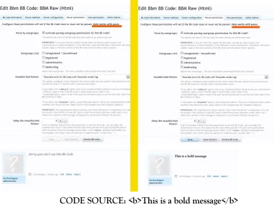

Hi
I've imported 'BBM Raw (Html)' but can't get the parser permissions working. No matter what usergroups I tick it always says "Sorry you can't use this Bb Code".
Any idea where I'm going wrong?
Thanks
Hi
Thanks
No. It's working for me.
P.S: as written many times this feature is only working with posts and is experimental. "Experimental" means it needs to be tested with several configurations). But make it working is not the problem. So it should work.

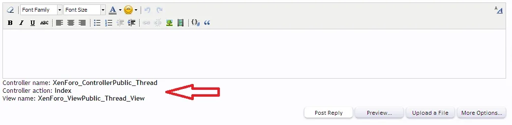

Hi Sir, i get the following displayed when i enable the add-on [v 1.1.7]. Also, am unable to see the Advance BB toolbar on my editor after installation. :(
Thanks in advance for all the help.
