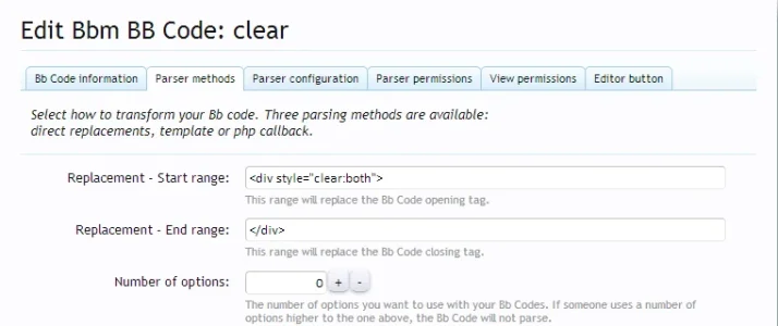

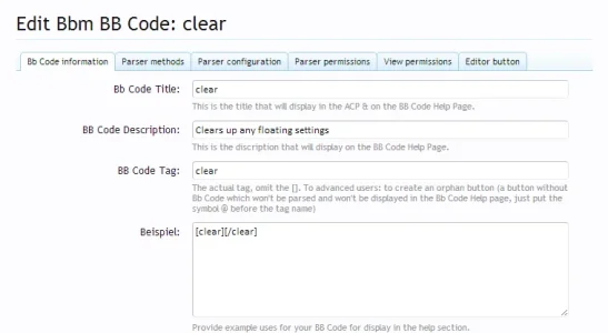

And this is the configuration of the clear-code:
It should be used to get rid of any floatings done by a float BBCode at any point I think it might be useful.
For example at the end of an paragraph. This is the reason why it makes no sens for me to have any Content between these two tags, but without the content I would get the fatal error form above.
This BbCode is working fine for me. The error message is the same than the "user" bbcode had when it was installed with the DigitalPoint ads position addon (I'm not sure if it's the correct title). You might actually have found why the "user" BbCode of Bbcm had sometimes a problem: when he hadn't any content. If it's coming again from the DigitalPoint addon, you should see this with him directly and tell him what you've found. It should help a lot. If it's not that, it might be hard to find. Do you have a lot of addons? (edit:=> to see if it can come from one of them)
