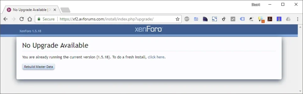

XF 2.0 AVForums test upgrade from 1.5.18 to 2.0.4 problem - No Upgrade Available error
RobParker
Have you uploaded all the files for 2.0.4?
That maybe suggests you're haven't been successful in uploading them. First thing I'd try is reuploading them.
Yes, that was my first thought, so I uploaded the files again.
.... I'd also check (then double check and then triple check) that the config and redirect are not pointing to your live site.
Config.php is fine. What do you mean by 'redirect'?

In the OP’s case the files were simply not uploaded to the correct location (a bit of confusion related to two different servers).
WesNSpace
Thanks Chris, I finally figured that out last night which appears to have been a result of sleep deprivation :). Thanks for posting that here as well.
