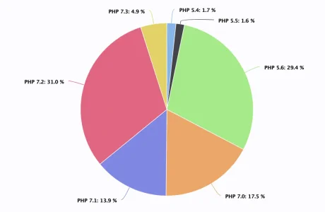

So, it's been a while since we looked at where we are with the spread of PHP versions. For comparison see the first post.
197243
Although it is encouraging to see 67.3% of people now using PHP 7.x (which is up from 54.8% last May) it still feels like there is work to be done if there's any chance that we would consider increasing the minimum requirements in a future XF version.
So, why are you still using PHP 5.x?

Only intended to be a simple and informal discussion at this point, rather than full scale market research...

The chart is installations that have submitted stats to us within the last 45 days - stats are collected when a site is upgraded or within 4-6 weeks (whichever is sooner). So it only includes active installs and people who haven’t opted out of the stats collection.
Ahh interesting. I'm actually surprised that it's such a high percentage still on 5.x then, considering it's 2.0.2 and above and the data is so recent.
Indeed great to see the improvement - PHP 7.2+ FTW
@Chris D have you considered that the use of PHP 5.5 and below has been practically wiped out possibly because XF raised the minimum to PHP 5.6? Anyone with desire to upgrade to XF 2.1 will have upgraded their PHP 5.5 and below by now. My guess is that if XF 2.2 would come with a PHP 7 minimum this could likely be followed by quick PHP7 adoption by XF customers.
