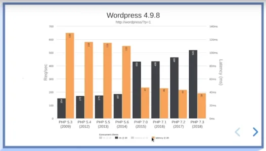

If your moving from 7.1/7.2 to 7.3, you code should be about 5-10% faster. If it's more than that you probably don't want to brag about it due to this :D
These graphs help demonstrate just how big of an improvement in latency and requests per second that can be echieve with moving to 7.x

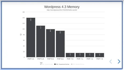

Memory usage has shrunk a fair bit

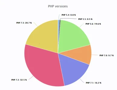

Current PHP usage is showing that PHP 5.x now accounts for fewer than 25% of installs.

Actually it might be possible that turning our back on PHP 5.6 already is a bad idea - it's still the second-most popular PHP version amongst our customers. That's nearly 25% of installs. PHP 7.0 would be another 12%. 25% is a lot... nearly 40% may cause problems. Or it may not. This will be a good test to see whether the best way to drive people to stay updated is to increase our minimum requirements or if it will just negatively impact adoption.
