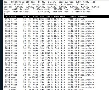

RobParker
Output from top
Most of the day the load has been around 0.8 or so but just had a bit of an increase due to traffic.
Even then we only had 500 users online (half guests) and VB was able to cope with several thousands.

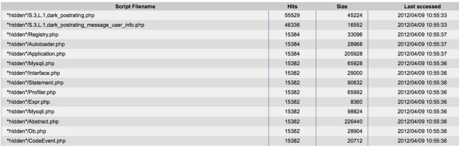

APC is working but we seem to be getting far more cache requests than we used to and this looks a bit suspicious.
Anything to be worried about?
