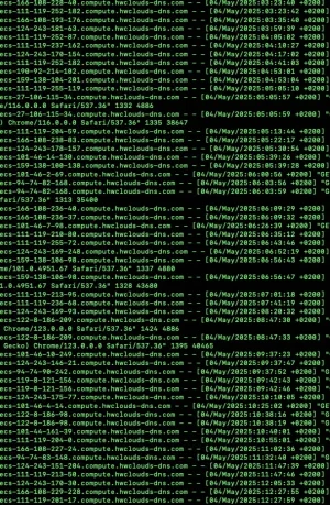

Here's a list of the top ASNs that were blocked by my firewall settings - the vast majority of this blocked traffic did indeed come from that Microsoft Datacenter ASN:
As I dive deeper and deeper into the unknown the more noise has been blocked successfully more and more of those come to the surface thad managed to hide successfully until now. Being aware of your screenshot I was curious if I would find the same players - and I did for the most part: There is a little bit of Hetzner in my logs, but not much. However, Huawei Cloud is a big and very nasty one. Someone from there seems to slowly but steadily suck down my forum contents, using a huge range of different IPs and as huge set of different useragents, claiming to be normal browsers:
Whoever does this is not in a hurry and rather tries to hide himself by acting very slowly, distributed and hiding the fact that a bot is used. So next job will be to block out the Huawei cloud IPs at scale as good as possible - sounds like a lot of manual work (the more, as the whois database is inaccurate and missing to display wider parts of these IPs correctly. Arin says they would have been delegated to ripe and ripe says "we don't know a thing", so it is manual work involved as bigger parts of the IP ranges have fallen in kind of a black hole.
