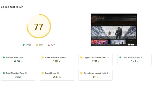

Desktop speed test:

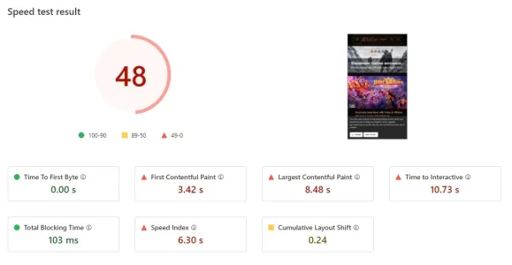

Mobile speed test:
So it's pretty bad, mobile is horrid.
So a lot of it is down to images I think. I have auto image optimization with TH Image Optimizer (paying for a Kraken.io plan). It's on max optimization with Lossy and stripping all metadata. "Swap attachments with thumbnails on mobile" is ON, so not sure why it is complaining about it being served some large images on mobile.
What I really need is WebP... (ahem XF 2.3).
And I want to make sure I'm not caching content 3-4 times
And that settings are as optimal as possible.
So what caching techniques is recommended of the above? What "works well together", and what should be disabled?
