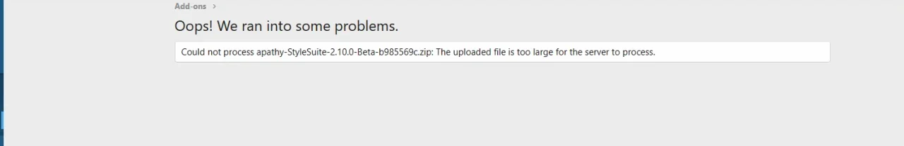

I'm getting this when installing.
I had to revert back to PNG & GIF for the frames / sparkles until XF2.3 is released with actual WebP support, so indeed the filesize of the zip is larger than usual.
You can temporarily raise your PHP max_upload_filesize to perhaps 8M and try re-upload it, or a manual install through FTP
