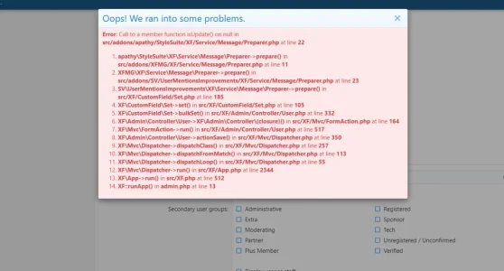

@apathy when I go to edit a profile in the admin panel, i get this error and it won't let me edit any users:
Error: Call to a member function isUpdate() on null in src/addons/apathy/StyleSuite/XF/Service/Message/Preparer.php at line 22
  1. apathy\StyleSuite\XF\Service\Message\Preparer->prepare() in src/addons/XFMG/XF/Service/Message/Preparer.php at line 11
  2. XFMG\XF\Service\Message\Preparer->prepare() in src/addons/SV/UserMentionsImprovements/XF/Service/Message/Preparer.php at line 23
  3. SV\UserMentionsImprovements\XF\Service\Message\Preparer->prepare() in src/XF/CustomField/Set.php at line 185
  4. XF\CustomField\Set->set() in src/XF/CustomField/Set.php at line 105
  5. XF\CustomField\Set->bulkSet() in src/XF/Admin/Controller/User.php at line 332
  6. XF\Admin\Controller\User->XF\Admin\Controller\{closure}() in src/XF/Mvc/FormAction.php at line 164
  7. XF\Mvc\FormAction->run() in src/XF/Admin/Controller/User.php at line 517
  8. XF\Admin\Controller\User->actionSave() in src/XF/Mvc/Dispatcher.php at line 350
  9. XF\Mvc\Dispatcher->dispatchClass() in src/XF/Mvc/Dispatcher.php at line 257
  10. XF\Mvc\Dispatcher->dispatchFromMatch() in src/XF/Mvc/Dispatcher.php at line 113
  11. XF\Mvc\Dispatcher->dispatchLoop() in src/XF/Mvc/Dispatcher.php at line 55
  12. XF\Mvc\Dispatcher->run() in src/XF/App.php at line 2344
  13. XF\App->run() in src/XF.php at line 512
  14. XF::runApp() in admin.php at line 13
TY for the report, I actually had another admin report this exact error, but the context to trigger it was different (they were hitting the error when trying to edit the first post in a thread).
Unfortunately I can't seem to reproduce it in either case, but I'll have a mess around tomorrow and try get a quick hotfix out then.
