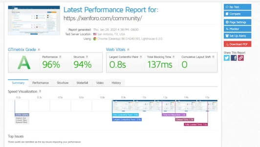

Xenforo is very well optimized out of the box (see image below).

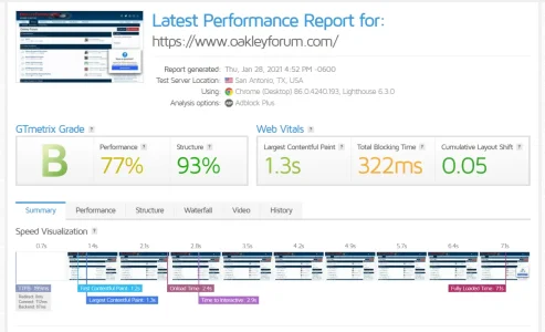

Look at the huge jump on your site just by blocking ads:
