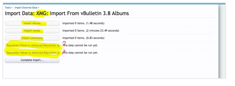

His code seems to be executing somewhere it definitely shouldn't and my code has worked for hundreds of imports so far therefore I would suggest it is his.
I would need to see the other code to be certain, though.
It seems there is some kind of bug when XenMedia is installed:
https://www.dropbox.com/s/2423pxaq4xsccrw/Screenshot 2014-10-29 18.13.40.png?dl=0
@Chris D your end or his?

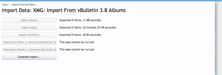

Can't you see from the screenshot what he's doing? He's clearly importing using the importer named XMG: Import From vBulletin 3.8 Albums.@BamaStangGuy, are you trying to import from the xengallery or the vb reputations from my mod?
@borbole your importer does not show up at all in 1.4.2 with XenMedia disabled.

Very small bug:
PHP:public static function load_class_importer($class, array &$extend) { if (strpos(strtolower($class), 'vbulletin') != false AND !defined('bdMedal_Extend_Importer_vBulletin_LOADED')) { $extend[] = 'bdMedal_Extend_Importer_vBulletin'; } }
This code will affect any importer which contains the word 'vbulletin'.
There is now a vBulletin Albums importer in XenForo Media Gallery so your extended importer is running there too.
