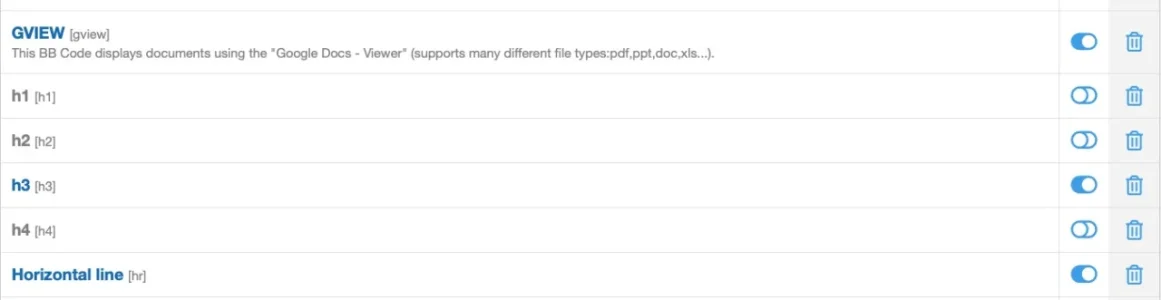

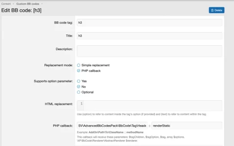

@Xon : Since 1.18.2 I have the issue that many of my H3s are nor longer displayed but as normal text instead. I remember having a sudden issue with headlines getting lost or additional headline BB-Code being displayed a while ago after having initially installed this add on - this could be fixed at that time by enabling the custom headline BB-Codes in the settings (in this case h3):

The issue was gone until the update to 1.18.2 of this add on, as I just verified on my test system with 1.18.1, both on XF 2.3.8.
The BB-Code of existing (older) headlines is:
Rich (BB code):
[h3]headline[/h3]
Whereas now it is set back to standard for new headlines which is
[HEADING=3]heading 3[/HEADING]

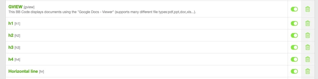

Said test system is a clone of my forum, thus the settings are identical to what they ere on my forum before installing 1.18.2. There, all the custom headline codes were activated:
So it seems that 1.18.2 has deactivated those codes but failed to replace the exiting BB-Codes in postings.

Those are all activated, I think the logic around only partially activating the custom h1/h2/h3/h4 bb-codes is somewhat buggy.
What version did you upgrade from, this will help me determine what installer code is being executed.
I reported the issue with lost headline formatting the first time on May 26th 2024 in this thread. At that time I had installed the add on freshly shortly before, first 1.14.7 on May 11th, upgraded to 1.14.8 on May 13th. To solve the issue i turned on all four h-BB-Codes back then. I then upgraded up until 1.15.16 w/o further issues as far as I remember, then my maintenance ran out.
From there I upgraded again to 1.18.1 when I updated to XF 2.3.8 two weeks ago and the h-codes kept being activated. no issues. With the upgrade to 1.18.2 all four headings got deactivated and I activated h3 specifically manually to see if it would solve the issue.
So the deactivating must have happened through the installer of 1.18.2. Worth noting that 1.18.2 also removed heading 4 from the editor - it was there up to including 1.18.1.
So I guess I can simply turn all four headings on in the custom BB-Code section and everything will be fine?
