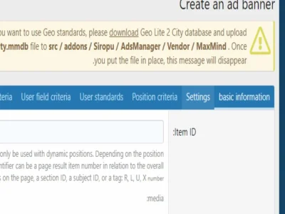

Hello
I have a problem
Cannot navigate through ad creation lists
basic information Settings Position criteria User standards User field crite

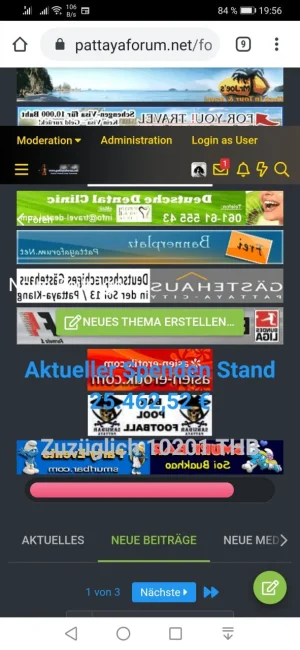

Using the latest version of xenforo, style and this Addon.
I use this Addon quit a while without any trouble.
But suddenly the adds messed up as you can see in the screen shot.
And I have a bunch of errors in the log.

Are you using the carousel feature? Did you got those errors during the add-on upgrade?
Yes I am using the carousel feature.
And no it don't happen during the update.
Was working like before. This came suddenly without any change to the forum.
The carousel I use in desktop mode for the header.
In mobile mode the carousel is used for all the banners to rotate on top of the page.
There was an issue with the carousel on the previous version where the CDN for the carousel script worked intermittently but it should work now.
Make sure that there are no outdated templates and the carousel device options are checked accordingly.
As for the errors, I don't understand how they can happen over night. Those errors suggest that the template functions added by the add-on simply stopped working which doesn't make any sense.
There are no outdated templates.
I also don't change any settings with this Addon.
Was working before with the same version.
Had to switch it of because it fills my log with this 2 errors and mess up the forum as in the picture
Try already to rebuild the Addon. No change in behavior.

I have checked your site and you have an issue with jquery which might cause the carousel not to function.. You are loading two version of jquery, one older 1.5 and the one that comes with XF.
Remove this:
<script type="text/javascript" src="http://ajax.googleapis.com/ajax/libs/jquery/1.5.0/jquery.min.js"></script>
As for the errors, template filers and functions are applied by XF so I have no idea why you get those errors, unless the code event listener for templater_setup has been disabled.
I changed now the source from Google to local.
Removed also the line of code. Was in a widget.
Did not change anything.
Same error and same behavior for the banner.
Where can I check this?
I did not disable something like this since I don't even know this.
